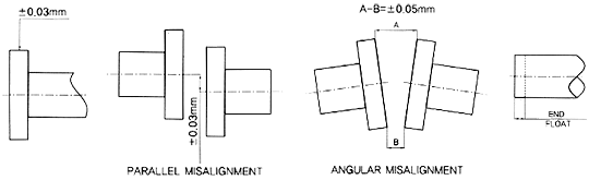

It could be that the Robur is more misaligned than the HG-1, which in effect gives you more boulders / large particles even with small grind increments.samuellaw178 wrote:The one notch of Mazzer adjustment seems to correspond to 0.015mm (according to 2 sources at least). The one notch on HG-1 are calculated to be 0.0133mm. However, I felt that the one notch on the Mazzer gave a much larger flow fluctuation (5-7sec) than the one notch on HG-1(3-4 sec). Could this be used for alignment indication (or it might be due to the inherent slack on the Mazzer adjustment thread)?
If we are talking about angular misalignment like here:samuellaw178 wrote:I guess this is also what Nick mentioned before but the reason didn't sink in completely for me. When you have a 'perfectly' aligned grinder, you get the full effect of the burr gap change of 0.015mm, for each notch you move. If you have a less 'aligned' grinder, the effect of adjustment is negligible compared to the inherent misalignment (you'd have to move more than one notch to see the adjustmet effect). That's why a less aligned grinder is more forgiving and vice versa.
http://www.dacell.com/images/sub10/acc_04_01.gif
and your A - B = 0.015mm, but the misalignment is caused by the burrs not sitting perfectly flat in relation to each other (so not entirely like it's shown in the link above, as there the shafts / supports are also misaligned), you will maintain that misalignment through the entire adjustment range (assuming the thread section of the burr chamber is machined at 90deg to the shaft's axis of rotation). Burr gap change per notch won't matter here, you will always have the same delta between A and B.

Thanks! The angular misalignment makes sense (I was too focused on the parallel misalignment alone).dsc wrote:It could be that the Robur is more misaligned than the HG-1, which in effect gives you more boulders / large particles even with small grind increments.
If we are talking about angular misalignment like here....
T.
