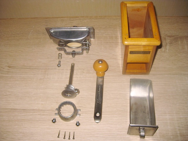

Hi,
I got recently a beautiful Zassenhaus Nr. 496 'Zasso' with newer version of grinding mechanism (comparing to the 1st version - all steel elements, exactly the same as in the Nr. 498 Rosel). I managed to restore the cherry wood box, but now I'm having some problems with burrs alignment in the grinding mechanism. Turning the upper adjustment knob raises/lowers the ultimate edge of the burr mounting strap while the opposite strap edge remains in the same position causing slope/horizontal movement of the inner burr as it is practically inflexibly connected with the strap. The bearing between inner burr and mounting strap consist only of a rounded bolt with 2 gaskets. It seems that there are no parts (like bearing ball) missing in there - at least according to the old-coffee-grinders.com website:
https://www.old-coffee-grinders.com/s/c ... 1470480525
Does anyone have experience with that model and can help me? The burrs themselves are in very good condition and it would be a shame to have a Zasso without being able to make a proper use of it :roll:

#1443: Post by grog »
Some of these old box grinders had a ball bearing in between the lower burr strap and some did not. I've worked on a few that had the bearing but it was so imbedded up in the lower burr, in old coffee oils and such, that it only came out after I soaked the burr assembly in Joe Glo.
I've experimented with adding ball bearings to grinders that lacked it, to see if I could improve it's ability to grind finer, with mixed results. It worked well on a couple of grinders, had no effect with a couple, and with a few I couldn't make it work or it made the fine grinding range worse / more limited.

#1444: Post by peacecup »
Yes, I've had a couple without ball bearings and they would not grind fine enough for espresso. Too bad, but still very nice for other brew methods.

#1445: Post by scontri »
Thanks for your answers! There's definitely enough space in the burr bottom hole to fit a ball bearing above the bolt head. So in the next step I will try to find a proper ball bearing.
