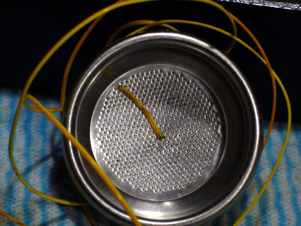

Depends how obsessed you are and how stable the machine is. I bought the Vibiemme knowing full well I would add a PID, thanks the excellent results Ken Fox got with his PID on the Cimbali Jr. I selected the Vibiemme because it has a very massive group, large boiler and heating capacity, all of which translate to thermal stability.
After adding a PID to the Vibiemme Domobar Super and using Eric's Thermometer Thermocouple adapter, as well as a self-constructed in-basket TC I have brew temps within a degree or so of 199°F.
Recently a fellow H-B'r was over and after he "Wow'd" a shot I'd given him, he exclaimed "Hey! Wait a minute! You're not pulling any cooling flushes!" :o
Nope 8)

The boiler is an uncalibrated* 234°F, about .625 bar, also uncalibrated*. The top of the thermosyphon inlet to the group is ~212°F as measured with a K bead probe jammed in nut, the bottom exit about 20°F lower. The group temperature is about 199°F with Eric's thermometer. When pulling a shot, the water temp is about 202°F on Eric's thermometer or about 199°F in the basket.
Weekdays I pull 3 shots at intervals from 10 to 30 minutes. Saturdays, a latte for the missus and then immediately an espresso for moi. Repeat in about 30 minutes. My Saturday espresso is a degree or so cooler than weekdays, but well within the yum zone.
I'd like to point out that the temperature measurements were all made well after PID installation and tuning by taste. I ordered Eric's adapter because it's so cool and to satisfy my curiosity that my taste buds are still in calibration. I'm not yet ready to return them to the manufacturer. :lol:
For the most part, I roast my own to 440-448°F, but coffees from Caffe Luxxe, Supreme Bean and Rocky Roaster all fair equally well.
*I've not bothered to calibrate the PID, probes, thermometers and meters as I have many probes of K and T types and several meters, and they all agree within 0.1°F. Someday, I'll use a GPS to get the altitude here, get some distilled water and a precision barometer to calibrate everything so the numbers are exact... Nah, I think I'll just pull another shot 8)
